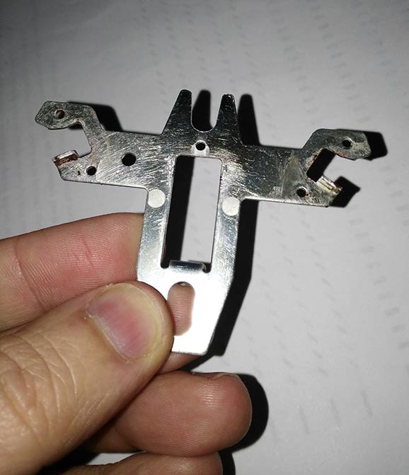

Well, after careful inspection, I've been able to find at least two problems:
- This machine has all its rubber parts (the ones which look like latex) rotten. The four washers that keep the tape "casing" with their corresponding screws have disappeared. That's not critical because no precission seems to be needed there.
- There is a metal piece covered by rubber at the bottom of the elevator lift which, by inspection in the other machine, I've determined it serves as a "brake". When it gets closer to the motor, they are used to stop them smoothly. They are released when you rewind, play and so.
Well, this rubber has become rotten, too. But, at the same time, it has become sticky, somehow like a gum, and has acted as a glue, keeping the tape mechanism and the piece stuck at the bottom of the video. Probably dried capacitors helped to permanently become attached as it didn't have enough power to take off.
The big "clack" noise I heard probably was the sound of it getting suddenly unstuck when I put the repaired supply on it.
I have disassembled the piece and cleaned it and the adjacent area.
This is how the good one looks in its place:
This is the dissassembled piece on its bare metals:
It would be good if some measurements where available for that piece, so that I don't have to disassemble the good one in order to make a cast of the rubber parts (to reproduce them), as I'm afraid of ruinning it.
The problem is that the Service Manual I have for the 404 is the ELECTRICAL one, not the mechanical. So no info about the piece (and we have yet to see if there would be any physical measurement, which I doubt).
Does anyone have the MECHANICAL service manual for these machines? Or can anyone help / give any recommendations on reproducing this piece? Surely it's not that much precission needed here, but I want to do it the right way...
More to come soon, as the problems with this machine don't end here...

These rubber pads only have one job: Holding both reels in Stop-Mode more than 15 seconds after switching the tape drive off. Because, both reels get stopped by the two winding motors, wich rotate in opposite directions. The central processor calculates the right torque for both motors, for all operating conditions: Play = right wheel puts tape up, left wheel holds the correct tape tension. Fast forward = right wheel has much more torque than the left one, Fast rewind: left wheel gets more power than the right one. And, by switching to "stop", both motors get as much power to stop both reels.
These rubber pads don't stop the reels from operating mode, like in any VHS-tape drive. They are just a kind of "safeguard" after switching off the motor power supply after 15 seconds.
Perhaps I have the mechanical service manual for the V-2000 800/850/880-series. Let me take a look into my repair room on Friday or Saturday. I will tell you then.
